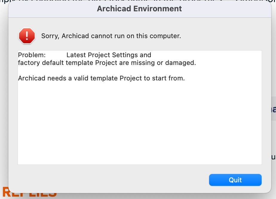

I have installed an INT and NZE version of Archicad 26 on my laptop (Macbook Pro, Intel) but there seems to be an error every time I try to start the INT version. Please see attached screenshot.
Each language version of Archicad (INT and NZE) has its own folder renamed to their specific version.
Has anyone had an issue with or tried doing this and had a similar error?

I've had a different experience running INT (my license) and GER version (cooperation with a german based office). The INT license doesn't support the GER version as well, so I had to adopt lots of INT version settings, additional built-in GER addons, properties, classifications and ifc translators..., a big headache.
Your problem doesn't seem to have anything to do with your license though, or does it?
It shouldn't be.
I can run the INT and AUS versions on the same license.
I would assume NZE would be the same although I have never tried it.
They are all English language versions which is why I think they can all run from the same license.
I can't run other language versions though.
The error sounds to me that it was not installed fully.
Maybe try a re-install?
Eduardo Rolon
They should run without issues.
IIRC a long time ago you didn't need to install 2 separate versions with just copying the folder and renaming it AC would work fine. The error you show reminds me of when things changed.
My solution would be to uninstall both versions of AC and restart.
Then reinstall AC and during the installation process change the name of the folder to AC INT (or however you like) and then run the installer for the NZ changing its installation folder name.
This should avoid one installation overwriting the settings of the other.

I tried one of the option of re-installing both Archicad versions (INT and NZE) separately again with different folder names. Same issue, only this time since I installed the NZE version second it is now the one that is showing the previous error message.
I may need to get in touch with Central Innovation, the reseller for Archicad in New Zealand to get this resolved.
NomadArchitect1988
Thanks Barry!
I tried your suggestion and still the same issue. Only difference is it is now happening on the NZE version as I installed it last.
Will try to get in touch with Central Innovation to get some further assistance.

I tried just installing and using the .tpl file of the INT version of Archicad but I do not want the add-ons showing up on the final model I am making. (i.e. Ci Tools, layer sets specifics for New Zealand, etc.) I am consulting with some Clients overseas and I feel that the INT version would be the best starting point as it is the cleanest and least amount of geography-specific add-ons or settings as I will be providing the Archicad file to the Client at the end of the Contract. I do not want to have the settings, add-ons, library that I have on my office template. As well as the extra data from the Ci Tools add-ons.
Sorry, can't be more specific than that.
