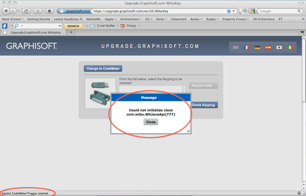

Additional info: see capture below

Having tried the process on Safari, Firefox, & Chrome, I'm still getting nowhere.
Can anyone shed some light on the error message I get every time, please?
I had same issue and same errors. I found out that it's Java's problem with certifications.
So what i did? I installed wibu driver from GS site on another random windows xp machine, restarted it and upgraded it there.
