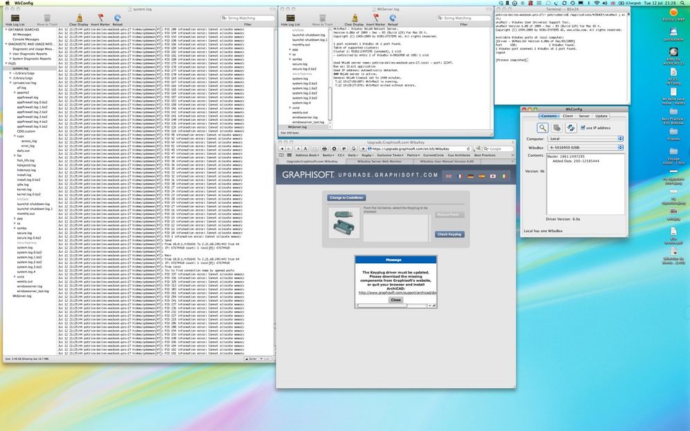

I'm trying to upgrade my WIBU dongle to AC15. Unfortunately the GS upgrade site stubbornly insists on telling me that I need to upgrade the WIBU driver - which i have done numerous times now...but the site does not recognise this.
I have followed the instructions given on ArchiCADWiki, the GS website, and the WIBU site, all with restarts etc. but to no avail.
My perception is that it is a Java problem - at which stage it is too 'techie' for me. Can anyone advise please?

Seems to be my lucky day: Just as I was about to embark upon a crusade to molest someone else's PC, Apple posted a Safari update which has solved the problem !

I had the same issue today and thought I'd share the solution from Graphisoft Support.
The problem had to do with Java not being preinstalled on two iMacs, recently upgraded to Lion.
Safari was the web browser we were using.
The advice was thus:
"To resolve this, it is one of those issues where you need to do the correct dance steps and perform the following procedures in precise order. Please follow each step precisely, even if you already have Java applied to your system.
First, skip to step 6 below and try the last few steps. If that does not resolve it then return to step 1 perform all the steps.
1. Remove the Wibu Key from the USB port
2. Uninstall the Wibu driver using the Uninstaller in the Install download.
3. Go to this link and download and install the Java update for OSX Lion: http://support.apple.com/kb/dl1421
4. Restart your computer.
5. Install the Wibu Key driver and then insert the Wibu Key into the USB port.
6. Visit https://upgrade.graphisoft.com
7. If you still see the message that you need to download the latest driver, close the message and refresh the webpage.
8. If the message still returns, use a different browser (Firefox, Chrome etc.)"
It worked for us using chrome.

I had the same problem. I found out, that Safari had Java applets turned off in Settings. After I allowed Java in Safari it went OK.

It looks pretty much like this problem:
http://www.archicadwiki.com/RemoteKeyUpgrade#A.22The_Keyplug_Driver_Must_be_updated.22
On OSX Lion the Java plugin is inactive by default. Click on the Inactive Plug-in label to enable the Java plug-in, then restart the browser as prompted.
