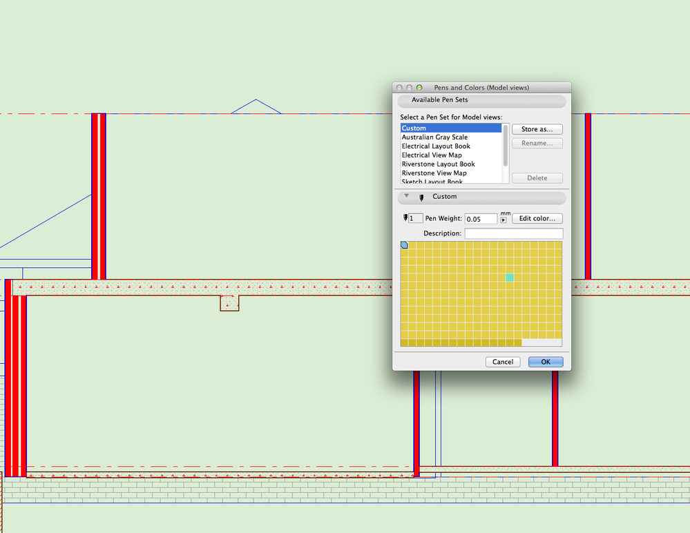

I just updated my ArchiCAD 18 to build 4020 and there are still certain things that did not seem to get fixed.
- slab thickness seems to show a strange number when stretching in section/elevations (no problem in 3d view seemingly).
- sometimes when I change line pens in plan views it does not take affect until I restart ArchiCAD ... eg. tried changing PEN #3 to pink. Save the new penset and nothing changed. In below example I have every pen set to yellow - pen set set to custom but I also tried saving the penset with it's own name and it has no affect on the plans. All my other pensets created earlier seem to work. I assume if I restart ArchiCAD it may take affect. Either way it seems to be an issue. I has happened to me on more then one project and more then one template.

I am surprised that there has been no comment on this. Am I the only with this problem?
It may be an issue with the Australian template in which case it needs to be looked at.
See the example, starting with a clean AUS template.
https://www.youtube.com/watch?v=WKAvMFEztx4&feature=youtu.be

I can confirm your odd slab thickness when stretching - both build 3006 & 4020.
And it is not just the AUS template.
Walls show the correct values in tracker when stretched and it all works fine in 17.
Have you reported this as a bug to GS AUS?
All horizontal sections and elevations seem to have the same figure and vertical sections elevations all have the same figure too but different to the horizontal ones.
I can't pick what it relates to.
But I am not having any trouble changing pen colours.

Graphisoft private messaged me following my post. Funny enough they confirm that pen colour issue was replicated by and reported as a bug but are still looking into or rather need more time to investigate the slab thickness bug.
Either way I hope it's picked up on next hotfix.
