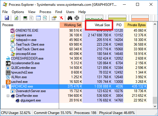

Checking Virtual Memory Usage on Windows
To check how much virtual memory an application (e.g. ARCHICAD) uses on Windows systems one has to use the Process Explorer application provided by Sysinternals: http://technet.microsoft.com/en-us/sysinternals/bb896653.aspx The standard built in Windows Task Manager is not good for this purpose because the term referred there as Virtual Memory Usage is not correct. So download Process Explorer and make the columns shown on the below screen capture visible:
Virtual Size is the term used by Process Explorer for Virtual Memory. So one has to check how much this value is close to the limit defined by the OS. As a side note it can be mentioned the Working Set column stands for the Physical Memory used by a particular application.
