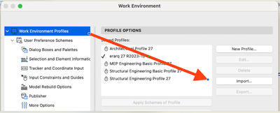

How to move a personal work environment from version 26 to version 27 ?

In AC26, go to Work Environment, select your custom Profile, click the Export button.
In AC27, go to Work Environment, click the Import button and import your Profile.
As Eduardo says, this will not include any new commands for AC27.

Thanks for the answers. You can import the keyboard shortcuts, but you cannot import the toolbars. I think it would be very easy to fix it, because the commands of an old version are always in the new version. The other settings are not so important. This is an issue to be solved by Graphisoft. Hopefully Graphisoft will fix it in the next update.

You can export ALL of the WE settings from a previous version, including Toolbars.
And you can Import ALL of them to the current one.
BUT
  • Shortcuts can be imported with minimum issues, because they will work correctly in the new version. You will need to review to optionally add new shortcuts based on the new versions added commands.
  • User Preference Schemes can be imported but since GS sticks in there new and "experimental" features it needs to be reviewed
  • Tool Schemes, Workspace Schemes, and Command Layout Schemes need to be recreated because they ignore the new versions upgraded commands and menu structure. If you import them new commands will not be shown.
