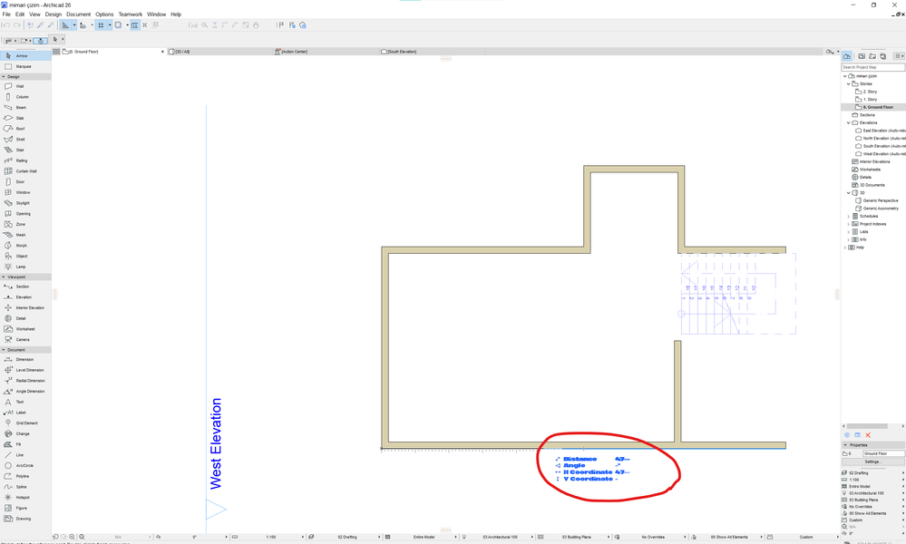

Hello friends. I started using Archicad version 26, but I encountered a very annoying situation. As seen in the attached screenshot, when I select it for measurement, some of it is unreadable and the texts are too thick. It wasn't like that in the old version. Because of this, I can't use the program right now. Can you tell me how to solve this problem?

I am not aware that there is a setting for the tracker font, I would expect it to be set in the Mac/Windows System settings.
Does it only affect AC26 ?
If you could supply a bit more information about your computer, operating system and version of Archicad including version and localisation / country e.g. INT, USA, FRA etc you may get a more informed response.
