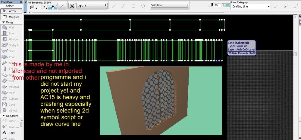

archicad 15 i do not what is happen to it but it always crashing and closing when i dealing with 2d symbol editing in script and sometimes crashing when i draw curve slab or draw half circle on worksheet really this is problem also changing 2d symbol becoming hard to me because i made the custom window semi arched and custom mullions what is i am supposing to do i have 4 Gb hard empty 3Gb ram and 1 Giga grapgic card and it works perfectly until this moment with archicad 14 (noting that i loaded archicad 14 library into my projects because i do not like style of windows and doors preview picture in archicad 15) and the specification as below i did not even start the project in archicad 15 all i did that i made this custom window below

It could be you machine specs.
These are the Graphisoft recommended specs.
I have highlighted where your mahine may be struggling.
Not sure about your video card.

With 64-bit system: 3 GB RAM is required, 6 GB RAM or more is recommended.
With 32-bit system: 2 GB RAM is required, 4 GB or more is recommended.
5 GB free disk space required for a full installation of ArchiCAD.
Additional 10 GB hard disk space required per project for work with complex models and 3D visualization.

Open GL and DirectX9 compatible graphic card with on-board video memory of 256 MB or more is recommended to fully exploit hardware acceleration capabilities.
You can find a list of recommended video cards at: http://archicadwiki.com/Video_Cards
