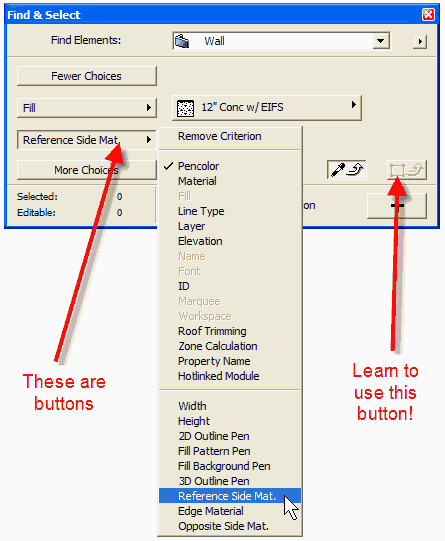

Rakela wrote:
sorry for being kind of rude before but, teach me how to get to the last item in the list without going thru the process of 'search more or show more'
You do realize that each 'choice' is a button, right? So, in the attached screenshot, you just click the button to get a menu of items appropriate to the element at hand ... and if you want the last item, you just select it.
This is so simple, surely you have a different complaint?
Find & Select is one of the most powerful things in AC. I use it continuously throughout the working day (via shortcut key), primarily using the "copy settings" button (red arrow at right of screenshot) [or the pick up settings option to alt-click an element] to match the settings of a selected element so that I can select everything else either identical or similar to it.
As Woody said, any set of settings can be saved, and used again in the future.
If I were to wish for anything for F&S it would be just to have fewer clicks to load/save settings ... put a little file open and disk-save icon instead of the two steps through the flyout menu that Woody illustrated.
thats it!!!!!!!!!!!!! i am voting 'not need it' and if there were something calld 'ridiculous complaint' i would obviously vote for that...
thx very much to all of you.
normally the 'copy settings' is good for me but i happend to need a narrower search and i didnt realize that with only a couple of 'criterion' wdws would have gotten to the bottom of it.
