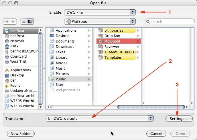

how to open DXF/DWG Document
when i choose the Open command from the File menu and select the DXF or DWG file ,dialog box DXF/DWG does not appear...?

it sounds as though you're using archiCAD 9? (put your version/system information in your signature file - it makes it easier for people to answer your questions)
when you open a DWG/DXF file with archiCAD 9, you don't get the translation set-up dialogue that you used to get with 8.1 . . . it simply uses the translation file that you specify in the open dialogue - see the attached screenshot: specify the translator file in (2), or make any adjustments prior to the open command using the settings button (3).
archiCAD 8.1 and earlier......
Miki wrote:
To me it looks more like missing Add-on. It that would be a version conflict proper window should appear.
paul is right - with archiCAD 8.1 and earlier you cannot use the 'open' command and simply select a DWG/DXF to open without first telling archiCAD that you want to open a DWG/DXF file type. additionally there are two translator add-ons that come with AC8.1 - one for r14 to ACAD2004 (which also reads 2005) and one for previous versions up to r14 (i think).
if using archiCAD 8/8.1 use the add-on manager (Tools>Add-on Manager...') to check that you have the correct DWG translation engine installed. if it's the wrong one, 'unload' the existing translator and load the correct one using the add-on manager (the other can be found in your 'Goodies' folder).
then in the 'open' dialogue, ensure that you choose the DWG or DXF file type in the drop-down menu of file types to open before you select the DWG/DXF file you wish to open - this is step (1) in the attached screenshot although not required in AC9.
