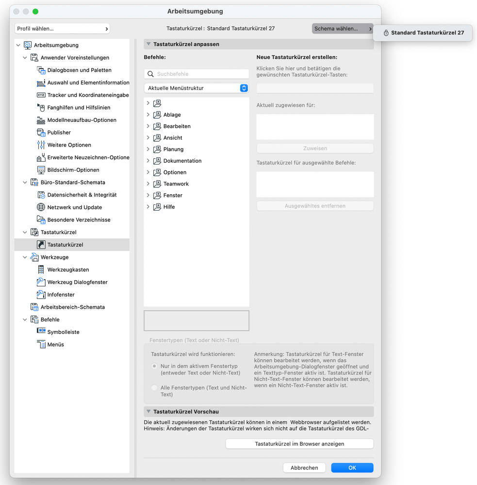

dear all,
I have used an english archicad version for the past years, now I'm working with a german one. since Ive gotten used to the english keyboard shortcuts; is it possible to download the english standard shortcuts somewhere, so I can upload them and use them again? I haven't found a file online.
thank you in advance!
best
abecker
Operating system used: Mac Intel-based sonoma
1 Reply 1
Eduardo Rolon
You will need to install a fresh INT version of AC and export them from the W/E or get someone with the INT version that can send it to you.
