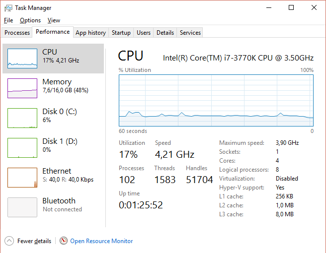

100% CPU load i see only during the photorendering. While working with plan/section/elevations/3D window CPU utilization is ~ 20%

I think that section, which is taking more than a minute to regenerate, is complex enough. There are 15 sections, 4 elevations
none of the cores is utilized more than 20%

20% is because the engine behind ARCHICAD don't utilize all the CPU power but 20% is not small, also when I update drawings, make complex sections...etc. The CPU utilization has spikes!

20% is not enough for me. It is quite annoying to wait 5-10 minutes just to change some property for all stud walls in the plan.
Jacques Toerien
I know it's one month later, but rather than looking at the graph showing the 'average' CPU usage, open the Resource Meter and look at the graph for each CPU core / virtual core. You should be able to see how the cores are used (or not) when updating sections / elevations / shadows etc. as you can see all the cores in one view.

I did it as well. Every core is utilised 0-20%
