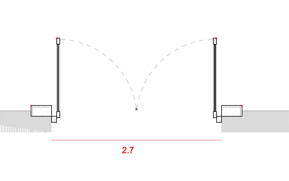

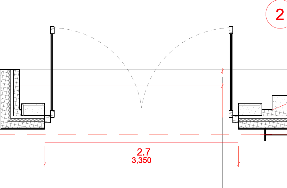

Hi, I know this is old but I am having a weird issue following these steps maybe there is something I'm missing.
I have create a custom door with trim and used slabs to create the Wallhole. Everything is fine in 3d. Now the 2d opening encompasses the entire door and not just the Wallhole so I will try to change the PARAMETER A (width) down to exclude the trim around the door. 3.350 > 2.7
In the 2D symbol window everything looks fine and the Wallhole reduces accurately.
But on the floor plan the actual symbol is scaled up back to the overall size, symbol included.
I hope this makes sense, any advice is much appreciated.
