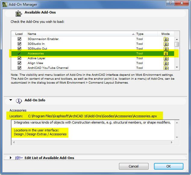

Also select the accessories add-on in the add-on manager list and have a look at the ADD-ON INFO section to see where it is installed.
Check both that you have in the list.
This image shows it in 16 but 11 should be similar.
The object library you will need to load through the Library Manager.
I don't have 11 installed so i can't say exactly where it will be but look in the ADD-ONS folder in the 11 program folder of your hard drive.
