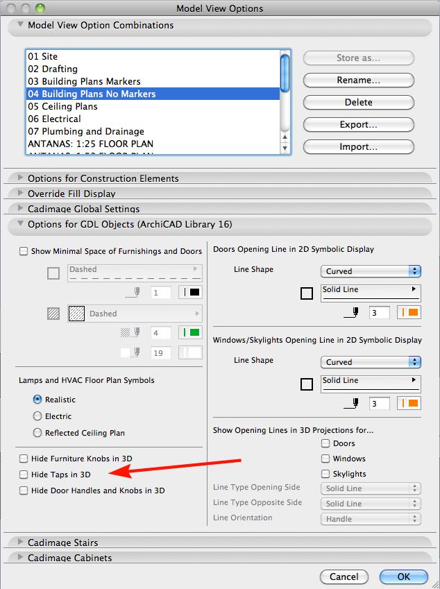

i'm working in 16 & been having this problem for a number of months now. i'm missing the handles for my cabinets & taps/faucets for kitchen & vanity sinks. this same problem also happens with my v14 files. it didn't happen before when we were still with 14 before upgrading to 16 & i can't remember when these problems started to happen.
pics attached, to show my setup & what things are activated in the objects.
the quirky one is the missing kitchen sink tap. you can see the tap in the object settings 3D view, but it is missing in the 3D window.
i tried to unload 3rd party libraries & strip down the library manager to just the ArchiCAD 16 library, ArchiCAD 14 Migration library, & a project specific library, which is currently empty, but no joy. taps & handles are still missing.

check your model view settings under GFL objects to make sure handle are not set to hidden
Have a look at your Model View Options, there is a section at the bottom for GDL Objects settings, where you can control visibility of taps, handles etc.
Gerry Leonor
good god, that was an embarrassing noob error.
appreciate the help & let's never speak of this again.
cheers all!
