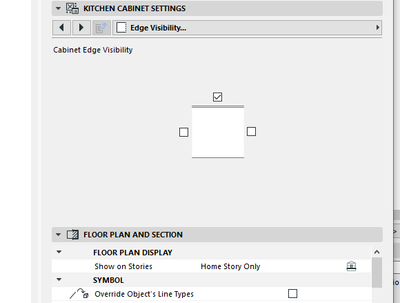

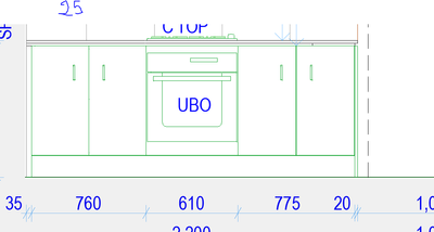

hey guys
so ive been using AC25 base cabinets and i moved to AC 26 recently.  in AC 25 it was automatically joining the footing of different units, but in Ac 26 it doesnt seem to join even though ive tried everything and now i kind of waster like 2 hours trying to figure out whats going on.
any help is appreciated

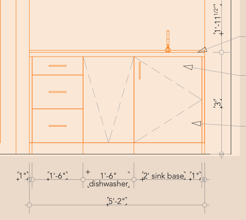

What a PITA - i'm migrating over to AC26 so testing the cabinet in lieu of using CI tools, but I also can't see anywhere to show the visibility of the side walls and shelves (dashed behind) in my Internal Elevations

I was excited to see that my question was already posted, with hopes that there was a solution.  It looks like there isn't? 😞 I'm not sure why Graphisoft would have down graded the cabinet library part to make these lines stay in version 26.  It makes the interior elevations look terrible and the only solution I can find is to place a cover fill over the lines!  Hoping that this gets fixed soon.
