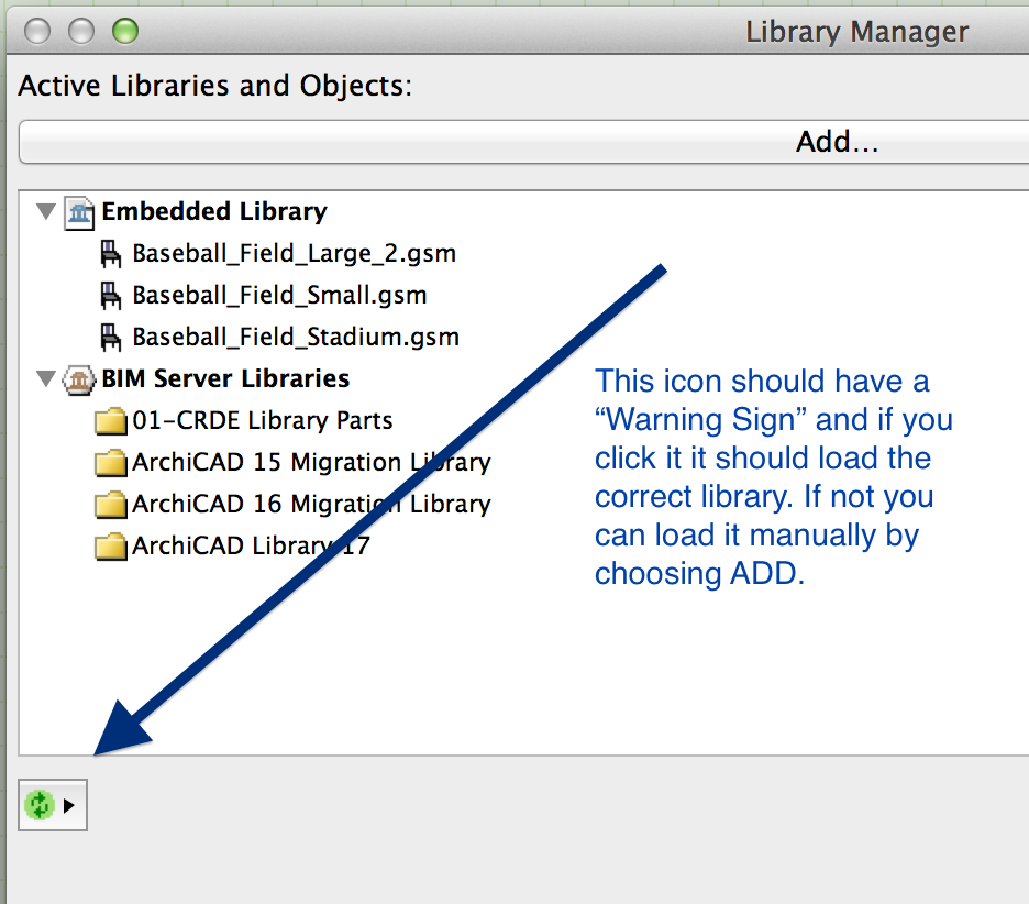

Is there someplace I can download the Archciad 11 library from?
I am trying to open an old project in 17 and I missing a bunch of the stuff.

Am I going to need all the migration libraries up through 17 too?
Eduardo Rolon
Look in your Application Folder-> Graphisoft -> Archicad 17 -> Migration Libraries.
You will only need to add that particular library.
