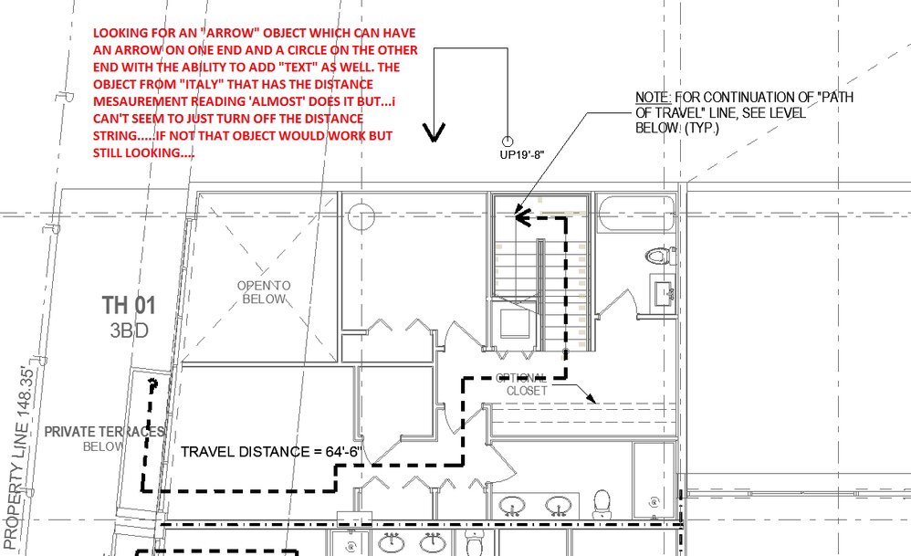

1. should have the ability to have an "arrow head" on one end.
2. should have the ability to have a "circle" on the other end.
3. can add custom text to either end.
we need this object for the stair path of travel.
we can seem to get the stairs to show the correct "UP" or "DWN" on the specific floors we need them to so we are having to shut down the text on the stair objects and just put a simple path of travel (arrow on one end and circle on the other).....
(see graphics attached).
