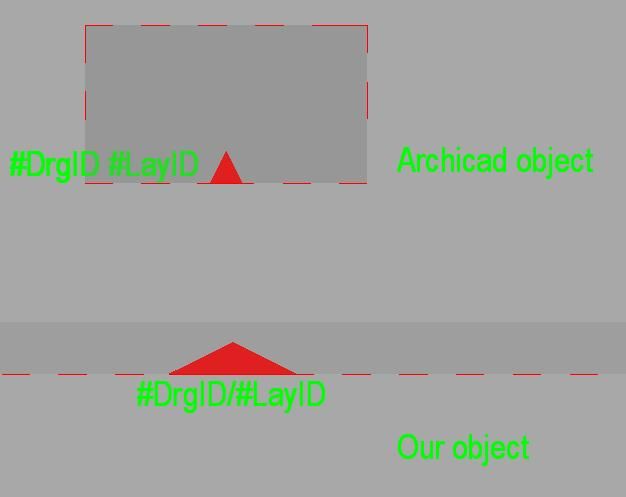

I am working on learning some basic GDL skills and had a question. I would like to edit the existing IE Marker to look more like our office specific markers. The triangular marker that comes with Archicad is close but I would like to stretch the bottom corners of the triangle to flatten it out a bit. see attached. I've been able to get in and play around with the object but can't seem to find a way to stretch it. Any thoughts?

Without looking, Id guess you're looking for a Poly2 statement to modify.

Thanks for the reply Tom. At this point I have opened up the object and played around with all the settings under parameters. I'm able to get the colors and text the way I need but cant find any properties to stretch the symbol. Also I've looked at the Master Script but really not sure about it.

Open the marker, then open the macro "Section-Elevation Marker Macro"
In the 2D script look for the following:
if GS_Type70 = 2 then
fillFrame = 5 + 2 * gs_backfill ! 5 / 7
fillType = gs_backfill_type
fillPen = gs_backfill_pen_fg
fillBackPen = gs_backfill_pen_bg
endif
if GS_Type70 = 3 then
fillFrame = 7
fillType = AC_MarkerFill
fillPen = SYMB_VIEW_PEN
fillBackPen = -1
endif
fill fillType
poly2_b 3, fillFrame, fillPen, fillBackPen,
-AC_MarkerSize * 0.5, 0, 1,
0, AC_MarkerSize, 1
add2 -AC_MarkerSize * 0.8, 0
endif if GS_Type70 = 2 or GS_Type70 = 3 then ! triangles
As Tom suggested you want to edit the poly2_b{3} statement. Without trying it, it looks like you merely need ot change the multiplier for the AC_MarekerSize variable. You will not find anything to do this in the parameter settings.

Erich, this is what I found. doesn;t match yours exactly but it's close. Is this correct? I tried what you suggested but I can't seem to get the changes to take affect.

Erich,
After I make the changes I am not able to load the new object. When I go to the Interior Elevation tool and try to search for another marker the ones I've saved do not show up.
I must be doing something wrong but can't pinpoint it.
