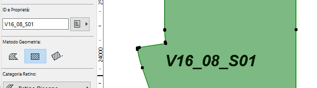

Hello to everyone.
A very basic question.
I have an ID of the hatch (see the attached image) with a three-part text.
Can anyone tell me how to split the ID of the hatch with a customized label?
thank you
Operating system used: Windows 10 pro

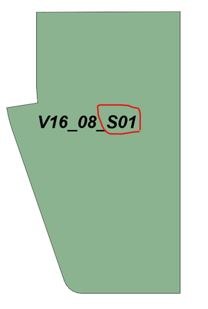

Hi what do you mean with splitting? Maybe can be useful to create a Pset with different fields for this task?
If I have the hatch with in ID, and for some reasons I want only the third part of the text, can I split with a label without erase some part of the text?

Check Expression-defined Properties in the Archicad Online Help.
You can create an Expression-defined Property, and you can use the expression to take the part of the ID after the second underscore character, there are functions to achieve that.
Then you can just use that Property in your Fill Label.
Nice to know thanks 😃
