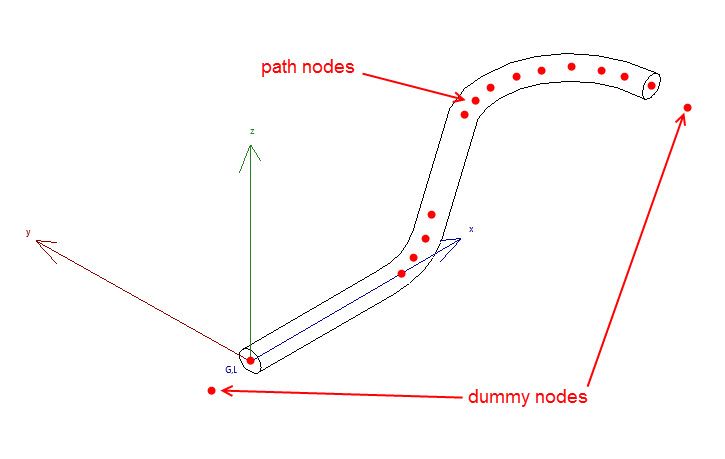

Here is a tube.
Can be more than just a simple curve - you define the path for it to follow.
The dummy nodes are marked in red.
The points between are the path.
The first seven co-ordinates are the profile shape (round in this case).
profile_rad = 0.005
TUBE 7, 18, 51,

-0.1, 0, 0, 0,
0, 0, 0, 0,
0.06367140388221, 0, 0, 0,
0.07133369552651, 0.0005952433182987, 0, 0,
0.07882204397126, 0.002318743681414, 0, 0,
0.0859664547359, 0.005147738336344, 0, 0,
0.09260476324691, 0.009017973839743, 0, 0,
0.1524367191209, 0.05051875591474, 0, 0,
0.1609741469947, 0.05387205483239, 0, 0,
0.1700752270737, 0.05501338288658, 0, 0,
0.1793046684196, 0.05383910007662, 0, 0,
0.1879460033734, 0.05039107776036, 0, 0,
0.1954004986649, 0.04493459948133, 0, 0,
0.2012639732361, 0.03779580958294, 0, 0,
0.2051680634349, 0.02942319141533, 0, 0,
0.2068892434645, 0.02034403381879, 0, 0,
0.2073142210857, 0.01737428732972, 0, 0,
0.2093970665567, 0.003530027058421,0, 0
