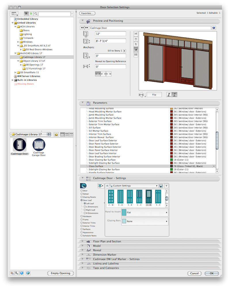

Silly- simple question;
I can NOT figure out how to make just a french door panel with a plain simple frame around a big pane of glass, like a 4" frame all the way around the glass.
In my attachment here you'll see that I have a big pane of glass, but I can only find panels that go under the glass. And in the other door leaf you can see that i have a simple frame, but I can not figure out how to get that big panel to be glass instead of wood.
Stress Co_
Open the " Panel to Insert"
Marc Corney, Architect
Red Canoe Architecture, P. A.
OH! thank you thank you thank!
