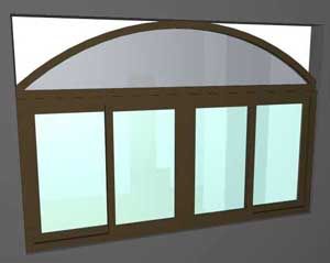

CUSTOM WINDOW PROBLEM
I'M TRY TO MAKE A CUSTOM CURVED WINDOW THEN WHEN THE WINDOWS WAS CREATER AND PUTED IN THE WALL THE WALL HOLE ITS A SQUARE NOT THE FORM OF THE SHAPE OF THE WINDOWS

Or you could model a slab, same shape as the overall window, make it the same thickness as the window as well.
Under listing and labelling, in the slab selection settings, change the ID of the slab to wallhole. Save your 3D model as a window.
There you have your fix.
