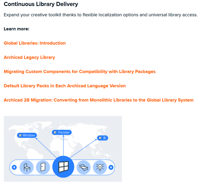

Have you already taken a look into this article from Graphisoft?
Martin Luther Jules

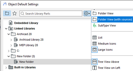

I think a 4th setting, "Legacy Library View" is what you are after(but it does not exist)
Using "Folder view(with sources)" does clean it up a little...adds the parent folder of your library to the list.
I have been using ArchiCAD continually since ArchiCAD 4.5
Member of Architalk since 2003, but missed the migration from Architalk to Graphisoft Communities. Melbourne, Australia
But it also splits up every single Library Pack that you have installed into separate folders.

Thank you for that article!
I had not read that. I think it confirms my initial general view that this libpack format was done mainly to make library development more streamlined in Graphisoft's end. This then of course serves the user as well.
Whatever the reason is that this problem exists, (some) third-party libraries need to be at least quick-fixed in order to behave similarly in AC28. Even if the quick-fix is to tell users to use the folder view. The fact that this is there in the final product* I think means this 'problem' could be here to stay at least for the default view. If just to maintain consistency.
(*although, if I'm not wrong, Graphisoft has lately introduced some sort of continuous feature updates, so who knows, maybe it'll be addressed in one of those)
A question that arose reading the article was - What exactly is the term "Monolith library": Is this a term that encompasses also the kind of third party libraries in my first example (the "MyLibrary" -folder or LCF), or just the old format Graphisoft offered library?
I'm asking this because in the Migration Guidelines -subtopic point 2. it's said that "... Mixing objects from the Monolithic and Global Libraries in the same project is not recommended. ... " I assume this means that there should be no version of the same object (or library?) in both libpack and monolithic format? This would be understandable. Surely it wouldn't mean it's not encouraged to use any other formats than libpack in the project at all?

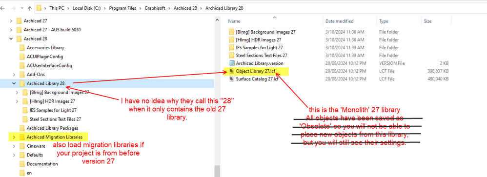

The 'Monolith' library refers to the older version Graphisoft library where all objects are contained in the one LCF.
The reason you do not want to use monolith and new library packs at the same time, is because they contain the same objects.
And, as there is no migration from older libraries to 28, you will have 2 places where you can choose the same object (old & new library).
If you load the 27 library that comes with the 28 installation, it will load the old 27 objects, but you will not be able to place them as new objects.
This is deliberately done this way.
They will be invisible to you as they have been saved as 'Obsolete' objects.
You will still be able to see the settings for those 27 objects already placed in your plan though, and you can continue to use them (they will never be updated any more).
But you will not be able to place them as new objects (unless you use the setting picker (pipette)).
EDIT: It seems this is not true.
The 27 library included with 28 is a fully functioning library and none of the objects are hidden or obsolete.
If you load the 27 library from the 27 program installation folder, then you will see both the 27 and 28 versions of the objects.
This will get very confusing and is definitely not recommended.
You will always know if you have an old object because it will have the version number in the object's name.
New object won't have this version number.
Using 3rd party LCF libraries with the libpacks is not a problem.

Sorry, I have given some miss-information here.
I am still setting up 28 myself and was just playing with the libraries.
It seems the 27 library that is found in the 28 installation files, is not an 'Obsolete' library.
It is the full 27 library and all of these objects will be available along with the new 28 objects.
They will not be hidden and only show when selected.
They will be available all of the time.
I think we could do with an 'Obsolete' 27 library.
That way we can still use it with already placed objects, but it will force new objects to be version 28.
I will make a wish for this.
https://community.graphisoft.com/t5/Wishlist/27-Obsolete-library-for-28/idi-p/636043#M1570
