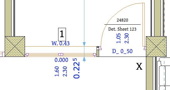

Here's a screenshot from my project. The Internal ID of the door shows in black, it's the "24820" part of the Label. I've got dozens of doors/windows in the project, all numerals, no hex whatsoever.
And, no, I'm not doing any API work.

TomWaltz
Why do you think that's the internal ID?'
Last I knew, the internal IDs were 8 to 12-digit hexadecimal values.

I am a little surprised about all these objections to non-hex strings possibly being the Internal IDs. Anyway, I downloaded the two label markers provided on this forum by Srinivas (http://archicad-talk.graphisoft.com/viewtopic.php?p=88478), and re-configured them to use the glob_intid instead of glob_id parameter.
I assume that glob_intid is the Internal ID of the door/symbol. Am I wrong?

TomWaltz
I've dealt with internal IDs at the program level before (for an add-on I wrote through the API), and they were in hex.
It's possible that the GDL engine uses base-10, but it's a little surprising that they would be differently formatted than other elements.

I don't know why they are not in hex; I tried also with walls: go into Label Default Settings, select the Wall element, then 'Internal ID' from the drop down menu to the right. Then select any wall, click on its 'Label Elements' checkbox in its settings, and up comes a number - no hex letters.
I also don't quite get your concern about anyone's wanting to use the Internal ID. After all, it's offered in the elements' info boxes, isn't it? It's even available in the Global Element Parameters in the Set Up List Schemes dialog. Why should GS make it available to the 'normal' user if we're not supposed to use it?
You are right about the reasons why I want to use the IntIDs. Ideally, I am thinking (but am open to suggestions/corrections) I should be able to create lists/schedules listing both Internal IDs (so we can guarantee that we are addressing elements in a unique way, not mistaking anything for anything else) _and_ User IDs (so we can devise an ID system whereby every _type_ of door shares the same User ID, for grouping purposes). Of course, other parameters could be used for analyzing data; library part names, widths and heights, or even their combinations, could easily serve the purposes of data analysis and break points (i.e. list-by parameters). It just seems odd to me that a fine parameter such as the Internal ID is, may be inaccessible for the reverse work of selecting (and possibly zooming into) a particular element.
