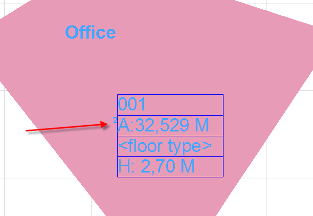

I tried Olivier's object.
Here is the result I got.
Weird, maybe it is my system.
It is an English XP SP2, but some of the settings are Hungarian regional settings. Could this be related?
2x28" (2560x1440), Windows 10 PRO ENG, Ac20-Ac27
Hi Laszlo & Kliment,
My workaround is a bit dirty, sorry, i made it in a hurry. Laszlo, what if you open the part, reinitialise parameters and save as?
I notice that the Zone_Stamp_02 11 has some improvements. I will look at it to write something more clean and parametric.
Check the attached image.
It is correct in the Settings Dialog preview, and incorrect on the Floor Plan.
However: I did a New & Reset and it fixed it. Now everything is fine on my machine, too.
