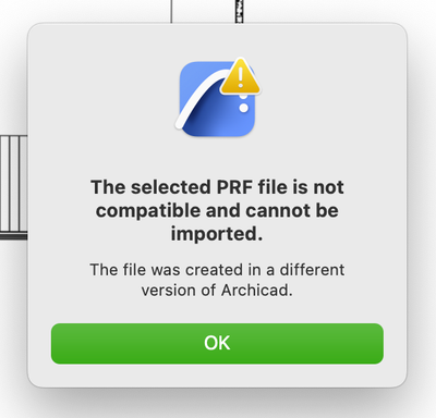

The selected PRF file is not compatible and cannot be imported. The file was created in a different version of Archicad.
No idea what to do, have ton of things in Favorites saved like this.
In middle of working on a project and need those Favorites.
Very basic flow that should work in Archicad across versions.
AC25 created the favorites and now opening in AC26.

As the message says, the PRF was created in a different version of Archicad.
They are not compatible.

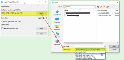

Oddly though, if you change the file type to look for a PLN and you can locate that file, I think you can import the favourites.

What do you mean to look for the PLN file? Like I should import the PLN file where I originally made these favorites and import that through the Import Favorites flow, and it will pull the Favorites from there.

That worked for whatever reason, thank you Barry!
Importing the PLN file through the Favorites flow. Though it just grabbed the Favorites from the PLN file which is good. It didn't like open up the PLN file.

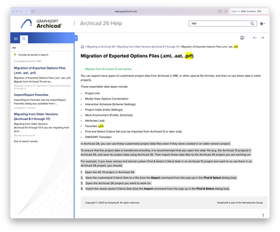

Bit more here, at first it says it should just import fine, which is logical.
But then it goes on, I think, to indicate you should open the PLN files and then re-export out the PRFs. So an extra step every new version.

Opening the old file in 26 and then saving the PRF is fine if you want to create a PRF that has only certain favourites in it.
Saves you hunting for them in the PLN when you try to import.
But if you are going to import all favourites, then yes, this is an extra step you don't need.
