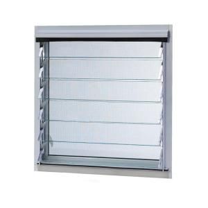

Can't find Jalousie Window library part
I'm a student at a tech school, trying ArchiCAD out and i love it, except the difficulty in making or finding library parts. I don't speak or read any other languages, so i don't know how to access much of what is offered in the links. If anyone can help me... There's ALOT of these Jalousie windows here in south florida and I need to be able to show them on my drawings.

You can try the window Vent Window 15. The louver material can be set to glass, and changing the louver width changes their spacing.

Thanks, David! That works perfectly!
