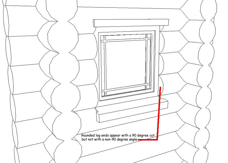

Dwight wrote:-Then sign me up!
Since it is made only of a cutting form, it will work on any wall.

Mwagner wrote:I am attempting to represent a window in a log wall, with no trim on the exterior, just the window frame. The window would have a chamfer cut into the log wall, a bevel cut, basically. We are using Theometric's Door and Window Builder 3.5. When the cut is 90 degrees, it represents correctly, as indicated in the images following. When we introduce the chamfer, it inserts a paper thin cutting plane that we can not remove. Any thoughts or experiances with similar situations? We would like to see the chamfer, and the rounded log ends............
