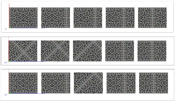

David Collins
Okay, here's what I've worked out. Let's have a GDL script which gives us a row of five prisms, each with a victorian grille bitmap material.
In the first row there is no Vert/Coor statement in the script. The first prism sits at the origin and shares the same origin and proportion with the original bitmap, so the grille is properly centered. Note the texture on the remaining four still starts at the global origin, so the grille on none of them is correctly centered.
In the second series, just after the script for the third prism, I've placed a vert/coor statement which rotates the texture 45 degrees. Note that prisms one and two are also rotated, while four and five are unaffected. Conclusion: Coor/vert statements change the texture orientation of ALL the elements that precede them in the script.
In the third series, I've added a second Vert/coor statement just before the third prism, which resets the texture back to the global origin with no rotation. The texture of the third prism remains rotated, while the others go back to their original positions.
Conclusion: GDL elements with customized texture locations must be bracketed with Vert/coor statements. The statement *after* the targeted object changes the texture origin and orientation. The statement *before* the target element must reset the texture to its global default.

David Collins
Sigh.
I should have "not dumb, just slow" written on all my business cards.
Here's the real answer:
BODY -1 needs to go before the target element script and after the vert/coon statements. This seems to limit the special texture orientation to just the elements between the two BODY statements and can include as many elements as you want. No need to write a second vert/coon statement to reset the texture origin.
All this was made clear by autoscripting an element with a custom texture orientation and then playing with the resulting script. (...And confused by the fact that I've been automatically erasing BODY -1 every time I see it...)
