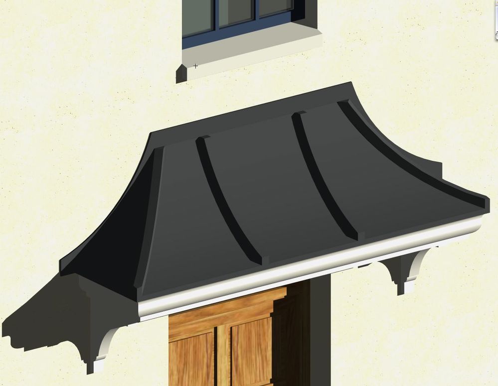

Hobbesnb wrote:Do you mean something like this?
Does anyone know of a method or object that would allow me to create an inwardly curved (convex) roof? I'm trying to create a roof over an angled bay window with standing seam roofing.

Hobbesnb wrote:It's an assembly of parts - mostly objects made with OBJECTiVE, a few slabs and walls. Not repeatable enough to make a complete object. Let me know by PM if you want an archive.
yes...exactly that!
is it a gdl object?

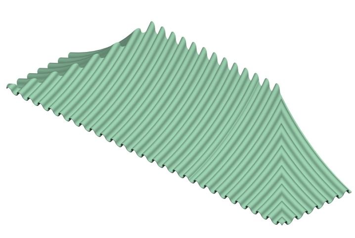

Dwight wrote:I think that's a good point - you can do many things with profiled walls - but it can end up being yet another painful work-around too. Getting the details right can become a real time-waster, especially if the design changes. It can push designers into either not using ArchiCAD properly (2D only) or limiting their building to what is easy to make in ArchiCAD. For example, if the concave roof in question had any kind of profile, complex profiles won't help at all. I made the attached image in under a minute, and the bending or shaping of the objects is all dynamic, i.e. you can readily tweak it until it looks right.
Standing seams are simple enough.
The point is that the complex profile deserves more investigation and application since it is so easy to edit after it is placed.
