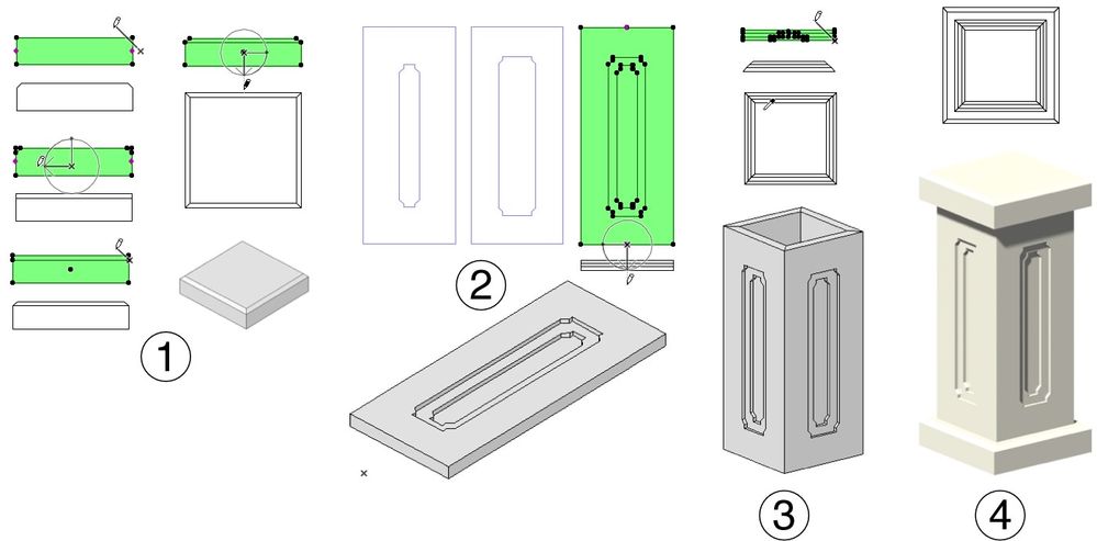

You could also make the other posts using OBJECTiVE's profiling, Split, and Rotate tools:
  • 1) Place a Regular Profile object with the bounding size set to the column cap. Use the Split tool to cut off the chamfers, rotate it 90 degrees with the Rotate tool, and use Split to cut off the chamfers on the other edges. Then use Rotate to tilt it back onto the level.
    2) Draw the profiles of the column face and make elevation profiles with OBJECTiVE's profile tool (OBJECTiVE->Component->New Profile). Stack the finished profiles on top of each other and use the Rotate tool to tilt them to a vertical plane.
    3) Use the Split tool to cut the mitres to the column face, and mirror copies to all 4 sides.
    4) Assemble the parts - result shown in 3D
