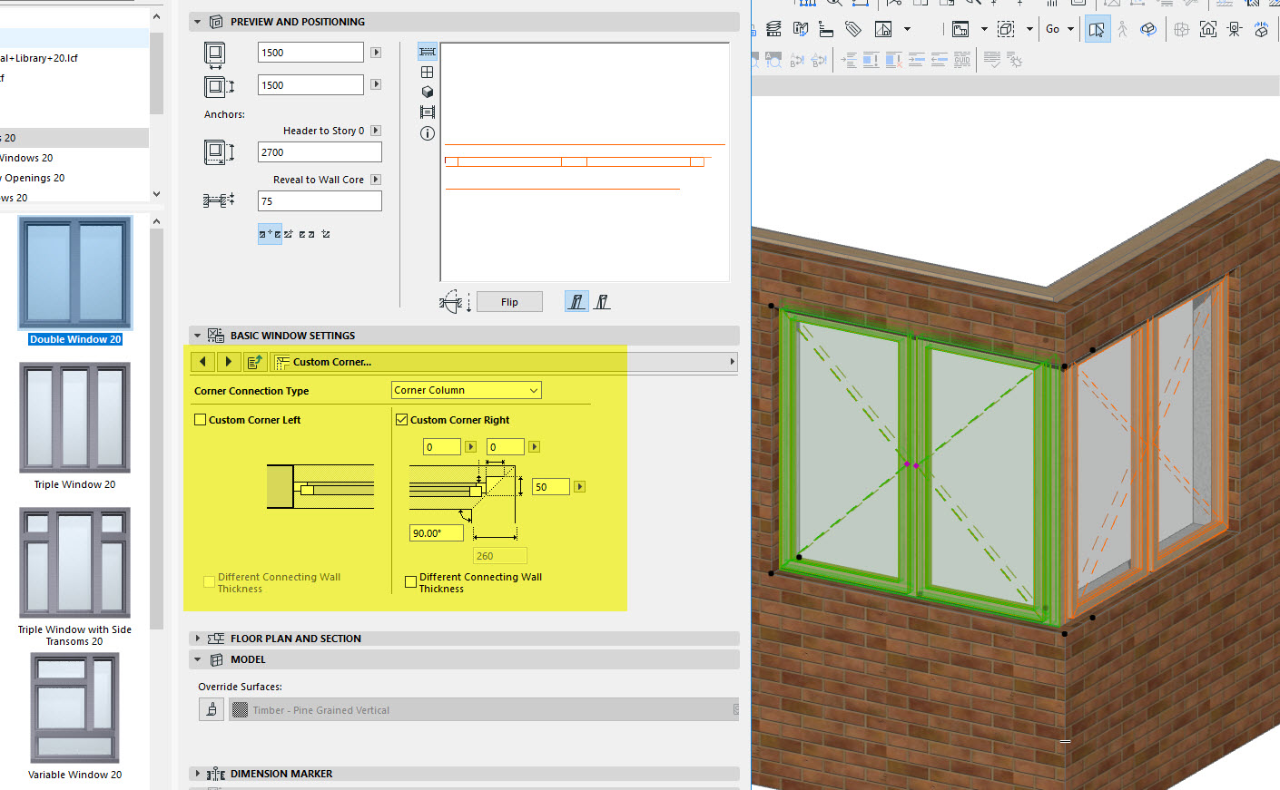

The attached image is one of the standard GS windows.
Make the corner setting and just move the window into the corner.
If you use the corner window tool you will be stuck with both windows being exactly the same.
Place them as separate windows and adjust the corner settings and they can be different windows and sizes.
