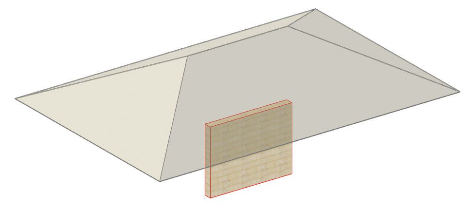

For my working drawings I just use a flat roof with a hatch attached to the surface material to represent the corrugations.
That way you can have the transparency if you need it and still see the corrugation lines from the hatch (see attached image).
You won't see the hatching in 3D OpenGL views but you can add a JPG image of a corrugated sheet (see image next post).
From version 18 you can create surfaces that have displacement so you can have a flat roof surface that renders in Cinerender with a corrugated effect so it looks quite real and can be transparent.
And the Open GL view.
