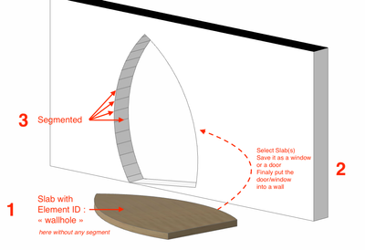

I have made a lot of "personnal windows" and doors by this way  (some with stained glass) :
- model with slabs
- on of these slabs get the Element ID "wallhole"
- I select all of them and save it as a window or a door
It is very easy but not as nicely as I want because the frames of these bays become segmented as shown below with this simple example :
Is there a way to hide or smooth these segments ?

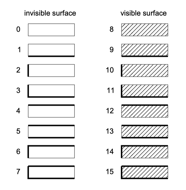

In the object, there may be a WALLHOLE command in the 3D script. That command defines how the wall is cut by the window and the command is as is :
WALLHOLE n, status,
x1, y1, mask1, ...
xn, yn, maskn [, x, y, z]
The x and y values are the coordinates of the wallhole and the mask is a value that defines how the edge at that coordinate behaves. It's that value that is called a status code and it goes from 0 to 15 : 15 is a hard edge and likely the value here so if you put 13, the edge will be hidden (but not smooth though).
Status codesStatus codes
Further info can be found in the GDL Reference Guide under Help/Documentation in the Archicad menu.

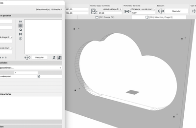

Thanks @MetalFingerz,
It's absolutly what I was looking for :
status = 7
status = 5
Here is a part of my 3D script :
wallhole	    90,      1,
        0.3898213060545, 1.703310120176,     varr,
        0.3457360846901, 1.719405134936,     varr,
        0.2546435546943, 1.742040857819,     varr,
        0.161661052195, 1.754865802279,     varr,
        0.06784210609928, 1.757734656572,     varr,
        -0.0257502774453, 1.750614915432,     varr,
        -0.1180556593356, 1.733587248371,     varr,
        -0.2080281827115, 1.70684458566,     varr,
        -0.2946484229318, 1.670689932355,     varr,
        -0.3769349380633, 1.625532935123,     varr,
etc.
With "varr" about status option.

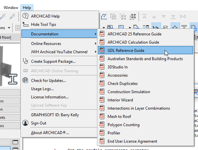

So is there no GDL reference in your HELP menu?
Or is there, but it is English?
I don't have any non-English language versions loaded to check.
