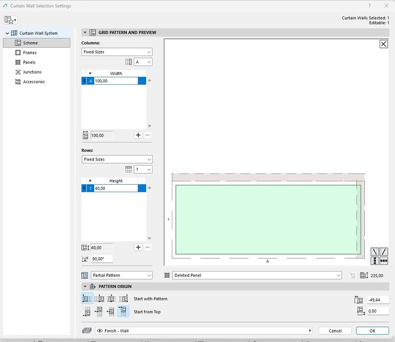

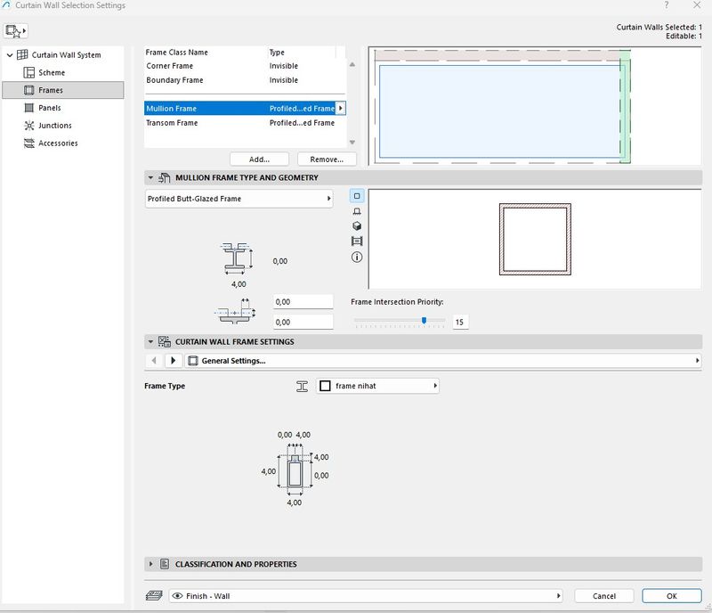

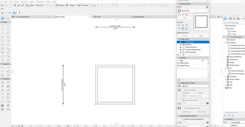

I'm trying to build a wall, using box profile construction. I'm planning it with 40x40x2mm carrier profiles (1 per 100 axes) and 40x40x2mm hatching profiles (1 per 40 axes). I created the 40*40*2mm profile using Profile Manager and defined it in Curtain Wall Frames.

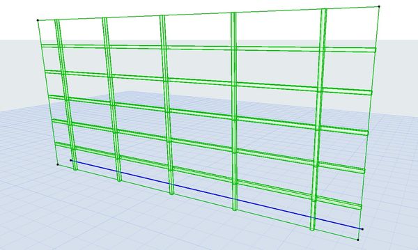

I want the profiles to be on both sides of the wall studs (front and back). Also, the hatching profiles should start from the ground, be placed at 1 per 40 axes, and end where the wall finishes. I haven't been able to do this. I'm attaching screenshots. I'm wondering if anyone can show me what I'm doing wrong.
My Custom ProfileMy Custom Profile
Curtain wall schemeCurtain wall scheme
Curtain wall framesCurtain wall frames

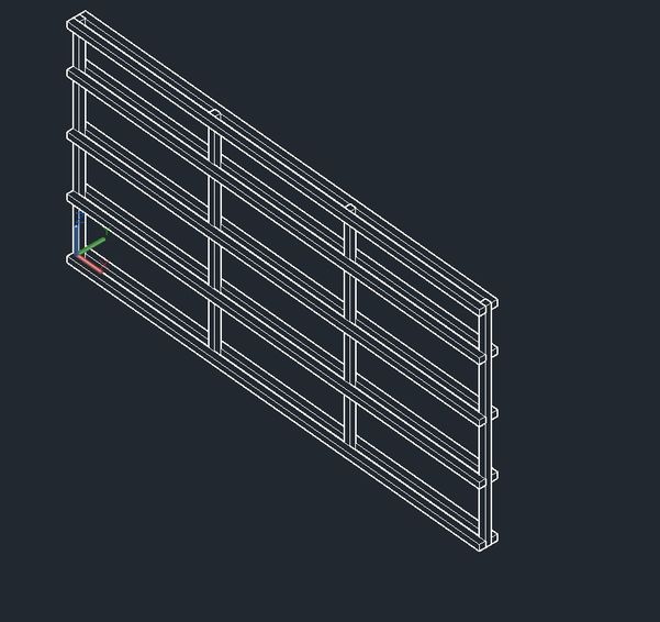

Here is my sketch for what i need;
Plan viewPlan view3d view3d view
sketchsketch
How can i do? Could you help me about this situation. (and yes, I will calculate the total profile length. This will be done in later stages of the project)

I'm not sure the curtain wall tool is the recommended one to use in your use case (since you are having doubled elements that you will want to treat independently). The CW tool has a "scheme" which will allow for complex shapes and even separate elements (having a custom profile with two independent parts, but those would still schedule as one single "frame" . It can be done that way too but you always have to remember which profile is actually doubled in quantity.
