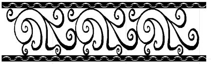

Here's shot of the railing.
This is really a difficult one, because profile is no good because it's not a solid continuous object.
Thanks for all the help so far, I wish there was an easier way to do this. Maybe a custom railing tool or something.
I could easily do this if the railing didn't have a radius, I would simply use slabs to build the railing and then save it as an object. But the frickin CIRCULAR thing is a killer.

I'm tellin' ya, just save your image as an alpha channel and apply it to a curved wall. This only took a couple of minutes.

To save you a little time, here's the image file I used for the above. It's a TIF file. You can probably create a higher resolution file on your own if you need a better image. This was just off of your JPG.

richard's solution is definitely the way to go
even if you did manage to model/gdl it the rendering time will likely become untenable
