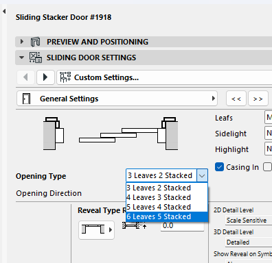

Witch is the best way to create an sliding door with 6 leafs?
Create ir as a new custom door or create only the leafs?

You have to create a custom door (including the frame) object.
Creating just the custom leaf (or 3 or 6 leafs as one leaf), will simply replace the door leaf used in a door frame.
The leaf will be resized to suit the frame,
You can resize the frame opening width of course, but it won't add extra sliding tracks.

There is a sliding door in the CI Essential Library that does up to 6. Was that a AUS/NZ thing? Does it still come with a Select (or what ever they renamed it to) Plan?
Ling.

where do i get this library?
Still there and under the same name in AC27.
AC8.1 - AC28 ARM AUS + CI Tools
24C GPU 7.8TF 32GB RAM OS Sequoia
CI is Central Innovations, look them up.
