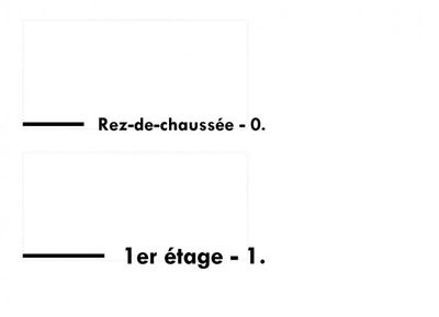

Hello!
I created a custom title block to use with my views on layouts.
However, it seems to be scaling itself and not be consistent with 3.00 text I wished. May I please have some help resolving this issue.
I wanted to create a title block instead of placing a text box underneath to automated safety.
Please see attached a screen shot of two views on layout with the same title block and text not being the same size:
Thank you in advance! Peggy

Yves
This is a problem noted on the Archi-CADlink forum
Solution open the object and add this line in the 2D script
FRAGMENT2 ALL,0

How did you create the drawing title?
Is it just the one title or have you created 2 different ones with different sized text?
Hi Barry,
I created just one title.
So you just typed some text and then selected it and "Save Selection A Library Part" > Drawing Title ?
Then you used that drawing title object in the drawing settings?
If so, then I just did the same and the text is a fixed size as it was saved and I can't change it.
So I am not sure why it would be different for you.

Hi Barry,
yes, that's exactly what I did! I haven't had problems before doing it this way, so it's very confusing!
But thank you for your help! It's very much appreciated!
Amazing! That fixed it!
Thank you very much Yves.
