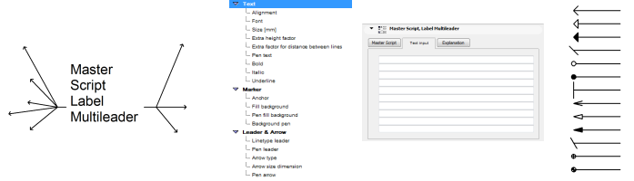

For the month February I have chosen to create the object requested by Dennis Lee.
He requested a label with multiple leaderlines. Pretty much as requested
here and here. He also send in an image as below.
So this will be the features:
-multiple leaderlines (up to 10 or more?)
-leaderlines on the left and right (optional)
-multiline text
-arrow options as in the label itself
So Dennis, am I missing something?
undefined
Dennis Lee
Thanks for taking on this object. The only thing I'd like to add would be the option to align the start of the arrow to the vertical center of the first line of text for a left arrow, and the vertical center of the last line of text for a right arrow.

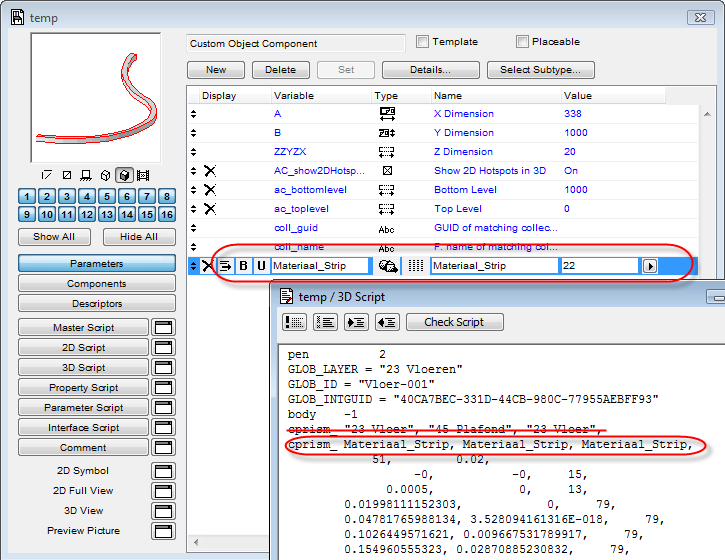

Great job , particularly useful custom parameters in object parameters settings.
I've tried with some custom handrails & balusters (pic. below) and I'm interested how to add some material parameters for those custom components(objects).
Yes, I saw those bottom lines in object parameters: "If you use custom component assign correct materials"; I guess it's because the file is saved binary so can't change the source file.
Best regards.
[edit: I noticed the object needs a tiny update for this to work, this will follow shortly].
[edit2: it is updated]
Hi floradesign,
Nice to see somebody using my object! You can control the material by changing some thing in your custom component. You will need to have little GDL knowledge.
Open your custom component and create a new material-parameter named "Materiaal_Strip". Then replace all material references in the 3D Script to this new parameter, see image below. Save the object and then you can control the material of the baluster within the railing object.
For the Handrail create parameter Materiaal_Handrail, for the Post create material Materiaal_Baluster and for the Baluster create Materiaal_Strip.
