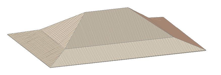

Can I give to a one of sheet roof (one sheet, not the all roof, just at one sheet of roof) two slopes (inclinations) in the same time. I know I can give one slope but two slopes in the same time!?

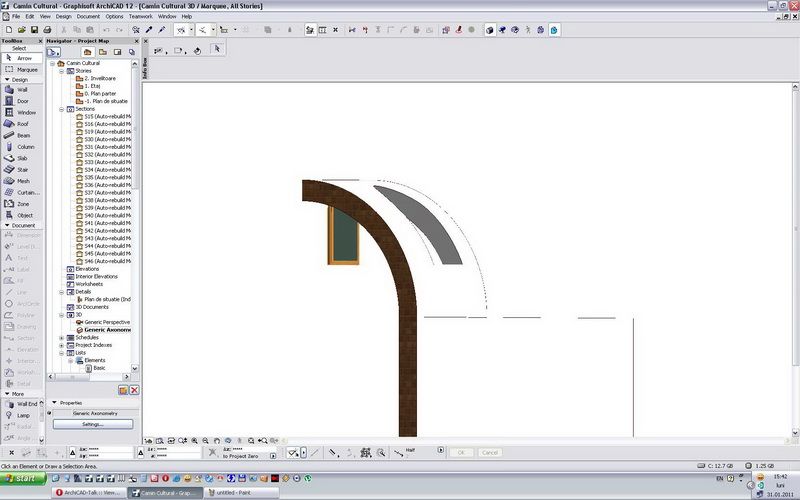

how can i insert this window in this wall? the wall is made with Capture Profile with Selection.
I think you will need to give more information to get answers to your questions. Pictures would help.
Re: Roofs. Each roof pitch can have only one slope. Multiple slopes require multiple sections of roof.
Each piece of roof can only have one slope (plane). For two slopes (planes) you need to create two roofs then join them.

About the roof, I had seen that in arhicad it's can have just one slope, not two, but here in romania are many anomalies at houses, i do not critical anyone, but it's ugly.
Can be a wises to arhicad to make a plane of roof with two slops? or we do not need this?

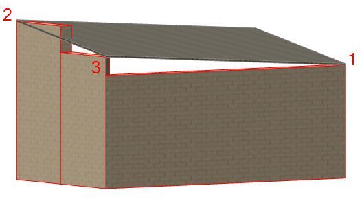

Jonyybe,
Sounds like you are trying to make a roof that slopes from back to front and side to side at the same time.
This is still a roof with one slope only but the roof pitching line will not be parallel to any of the edges.
The hard thing is to work out at what rotational angle this roof pitching line actually has.
Fortunately drawing the roof in 3D is very easy.
Set up walls to the heights you want the roof surface.
Then in 3D draw the roof.
The first two points you choose shoul be diagonal to each other.
This will be the pitching line.
The third point you choose will determine the pitch of the roof.
Then you draw the polygon (or rectangle) for the shape of the roof.
Wokka

LE: Barry what did you do in the both picture it's simple to do, i think you do not understand, or i do not explain right.
One roof with 2 slopes, that has 3 hights, first the it's the highest (point), second it's medium(point), and last it's the lower hight(point). i will put an picture this week.

As per the original image it is one roof that appears to slope in two directions.
It really is still only sloping in one direction but at an angle.
This one is sloping down from back to front and also left to right at the same time.
The front right corner is the lowest point on the roof.
The back left is the highest.
Or do you want one roof plane that changes pitch?
This is simply two separate roof planes.
