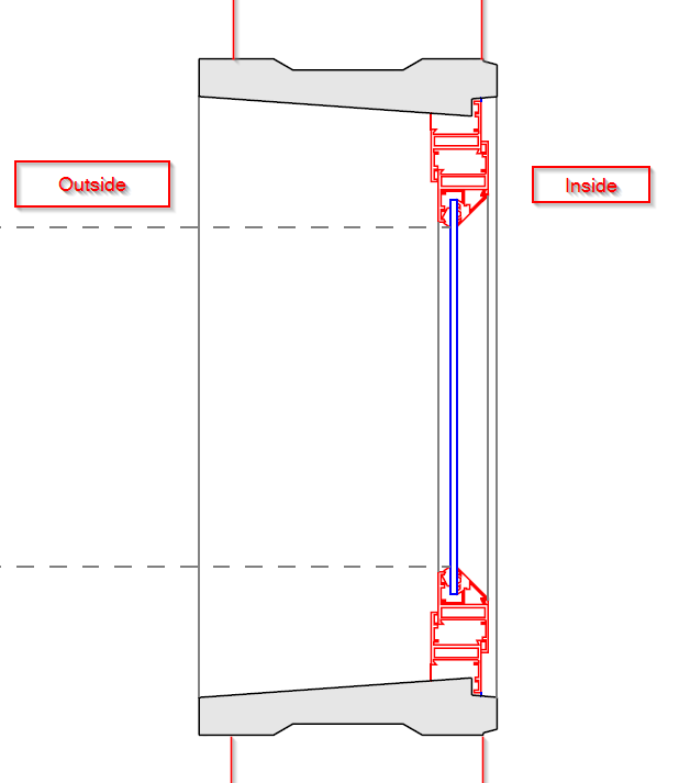

so I'm looking to model a custom window as follows, the window consists of a precast concrete frame with a top hung aluminium window insert.
I can model the concrete frame and window no problem, but when saving the custom window how can I indicate the opening part of the window?

If you mean the sash opening lines in elevation then I would model these on your glass with a morph line before saving as a custom window.
I haven't tried this but it should work.

Yes the opening lines exactly, thanks Barry will give the morph lines a go
