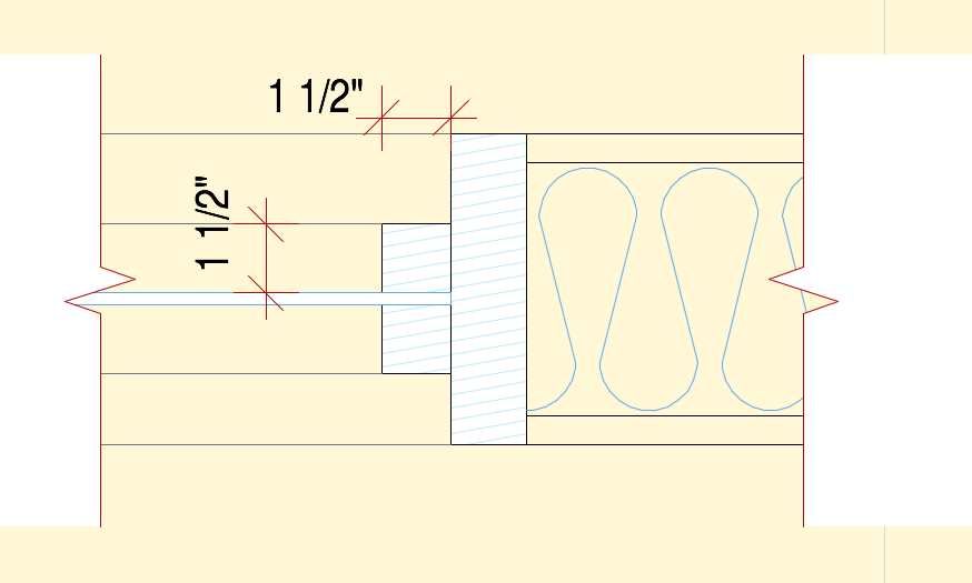

Anyone know how to get a fixed window to show as a Direct Set Glazing like the attached picture? Thanks in advance!

Is a "direct set" window a sash-less window that doesn't open and features glass that is glazed directly into the window frame?

Chris Grantham
That is exactly what I am looking for.

Actually, I think you can configure W Fixed 14 to look like what you need.
The trick is to make the frame .001" thick and make the sash look like the frame. You should be able to do this with your ArchiCAD 12 window as well.
Does this look like what you need?
