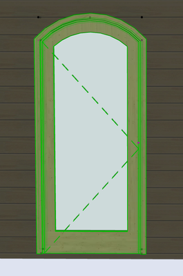

In Archicad 22 when I use an arched door, the hole in the wall it is square doesn't follow the arch of the door.it is not with a library part that happens, but with Archicad door library!!
Any help

Can you show an image of the object setting dialogue for the object you are using?

Odd... Arch Door 22? Please add your AC details and some general computer specs to your signature as some issues are version / os specific. Are you able to share a .pla?

I have the same problem in my existing project using AC26 with Archicad library 26.  The single leaf door is the only one that appears correctly.
I have tested them in a new AC26 file, every door type works fine.
Is there any solution for this? Thanks!

Looks to me like you will need to send that file to your local support for them to have a look.
If a new file in 26 works, then obviously it is a file specific problem.
Correct libraries not loaded (or maybe duplicate or unnecessary libraries loaded)?
Or maybe it is a Legacy setting?
Why 2 out of 7 work is a bit of a mystery.
That is why someone (support) will need to look at the file.
