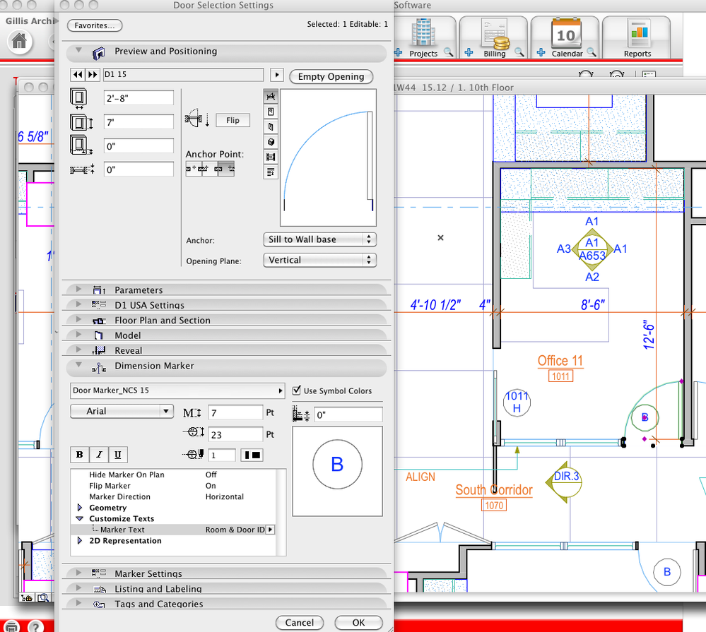

Look at attached two images.
One is of D1 15 swing door, with Door Marker NCS 15, not working.
11 Replies 11

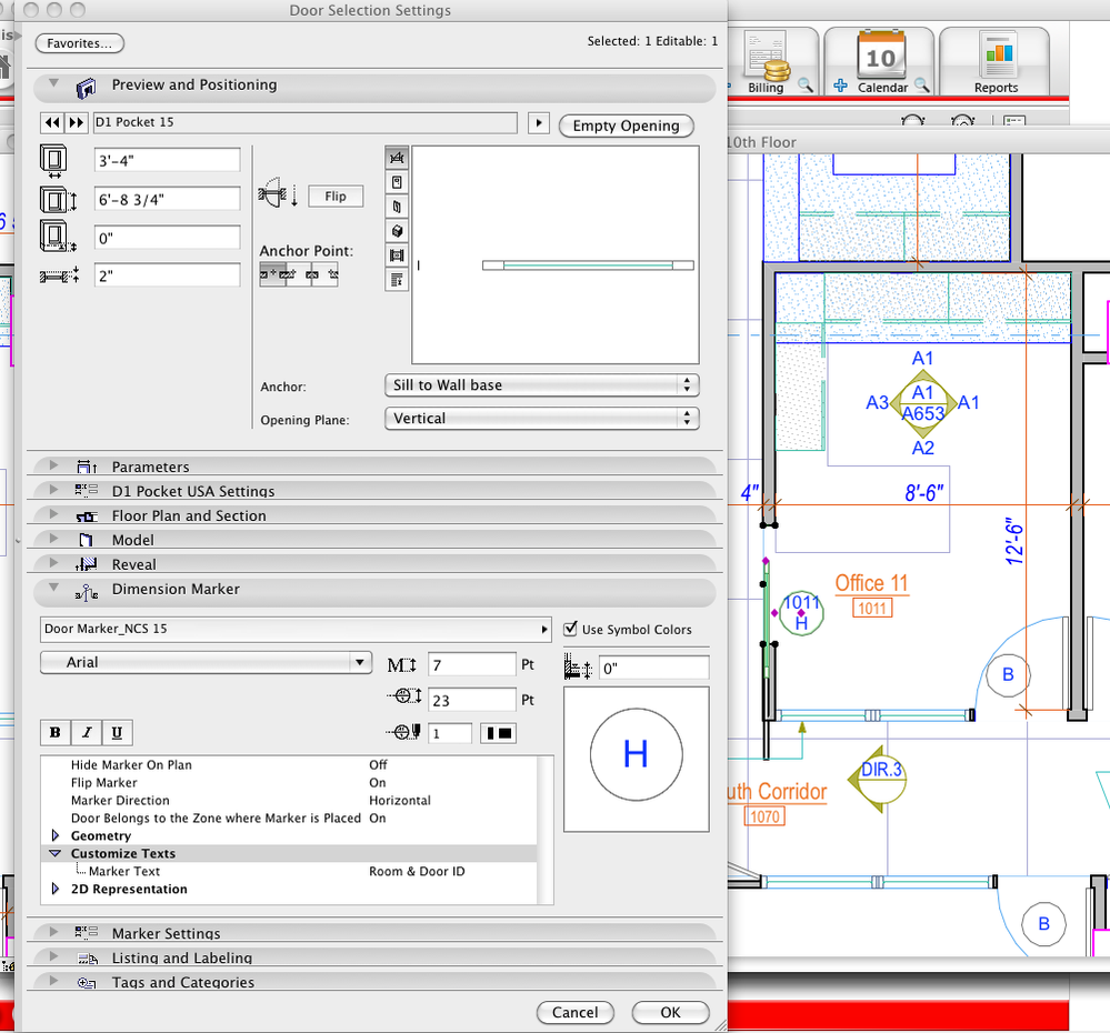

Here's the other Door image.
The one that works.
Just to clarify the different interface.
The one that works offers the switch: Door belongs to zone where marker is placed
