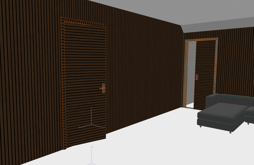

I am using AC25 library doors (In AC25 Solo), one pocket, one hinged -- both doors have the texture rotated 90 degrees.
Also same behaviour for architrave - texture runs perpendicular to material direction.
My room has vertical timber acoustic panelling for which I have set up custom surface, material and composites for walls; however, when I apply the surface to my doors, it displays perpendicular to the walls.
As others have said before, yes, I could setup a duplicate surface and rotate it 90 degrees, but is this really the best solution to this issue? What am I missing?

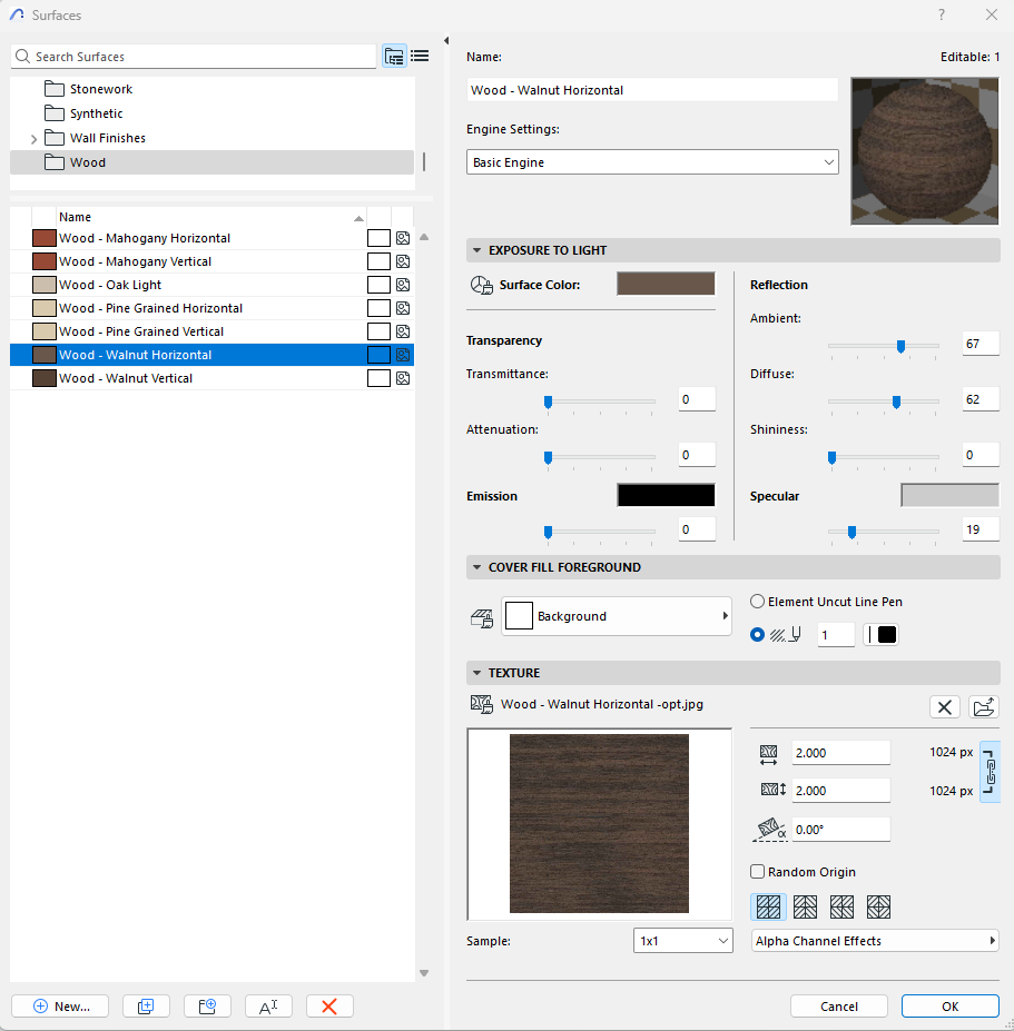

Hi @MLWheeler ,
Did you try to change the rotation angle for the surface you created?
See these screenshots.

Hi Mahmoud
I have done this as a work around - i.e. created a duplicate surface and rotated 90 degrees.
It seems like a poor solution to have to do this for something that should 'just work' - surely I should be able to attribute the same surface to a wall and a door and not have one appear perpendicular to the other. There appears to be broken logic in the geometry of some objects.
There doesn't even appear to be a way to manually realign the texture to these objects or faces.

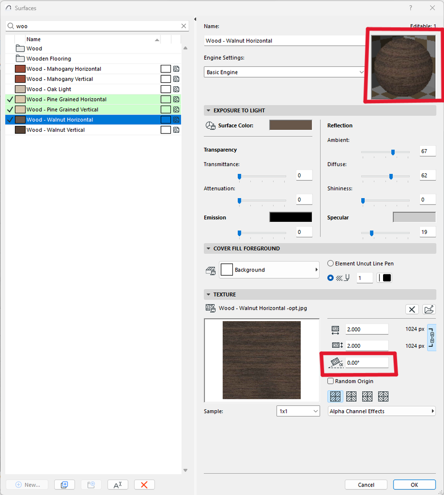

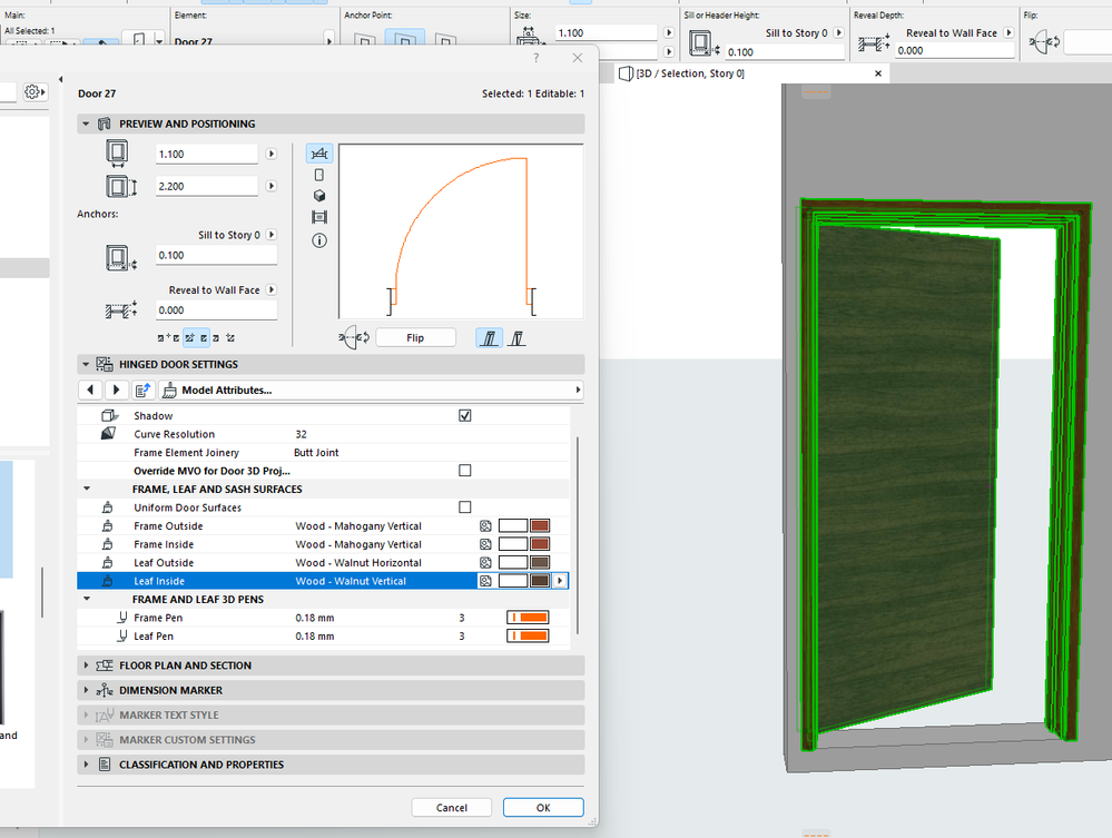

I've found something i don't know if it's a bug or a matter i can't understand,
As you see in attached screenshots that any wood material like walnut one, if Horizontal the rotation angle is (0) & if Vertical rotation angle becomes (90).
Screenshot 2023-09-29 224033.pngScreenshot 2023-09-29 225750.pngScreenshot 2023-09-29 224043.pngScreenshot 2023-09-29 225809.png

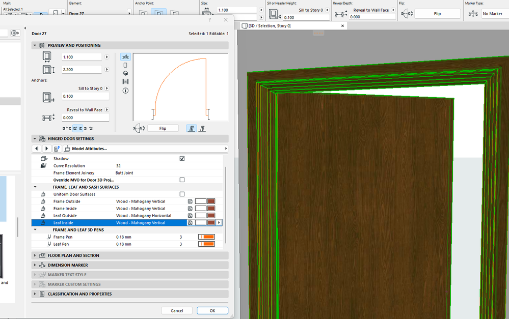

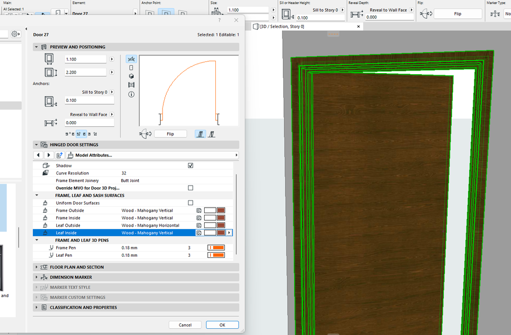

And in wood Mahogany if Horizontal and set to (0) & Vertical is set to (90) the result is reflexed when applied to a door,
Screenshot 2023-09-29 222159.pngScreenshot 2023-09-29 222019.pngScreenshot 2023-09-29 222212.pngScreenshot 2023-09-29 222106.png

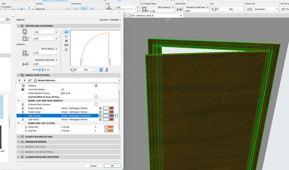

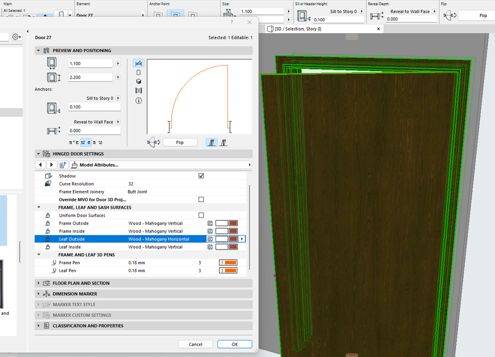

That could be solved when i set the rotation angle to (90) for Horizontal Mahogany wood & (0) to Vertical Mahogany one.
Screenshot 2023-09-29 222229.pngScreenshot 2023-09-29 222507.pngScreenshot 2023-09-29 222240.pngScreenshot 2023-09-29 222532.png
There may be a problem or i may have conflict between Inside & Outside.
AC 28 INT 5200/WIN 11
