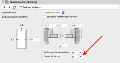

Hello,
In France we are able to cut each door leaf 5cm upper the floor with this parameter : 
Christophe - FRANCE
