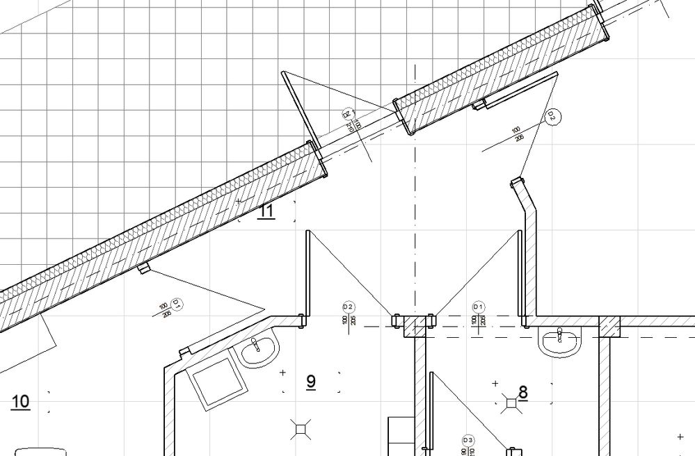

Hello everyone,
I'm having unusual problem (for me :/): all doors on plan view are represented as triangles. I can't find any solution for this. Can anyone help me restore them to normal (arc) look?
thanks in advance,
Kyle
EDIT: it happened after uploading project file to BIM server.
2 Replies 2
It is a Model View Option.
Check in this Dialog the page for GDL Object and look for the setting controlling opening lines of Doors in 2D (Straight vs. Curved).
Thank you, for really fast response.
Indeed, option responsible for opening lines was triggered to Straight line.
(Document>Model representation options (Alt+Shift+2)> GDL options)
