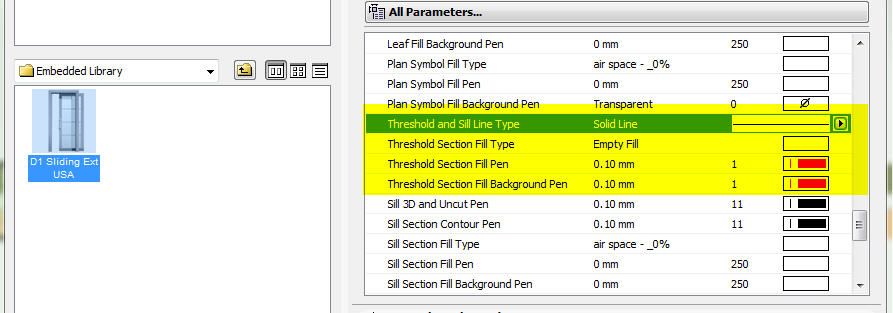

I downloaded a US sliding door from BIM Components (I couldn't see any hinged entrance doors) but that does not have the same threshold options.
But I notice in the parameter list you can control the threshold line type and pen - you just can't turn it on or off.
Which again makes me wonder if it is controlled in the Model View Options.

Maybe it is the fill type and pen colours?
Change from 'Custom Settings' to 'All Parameters" and see what is set for those.
