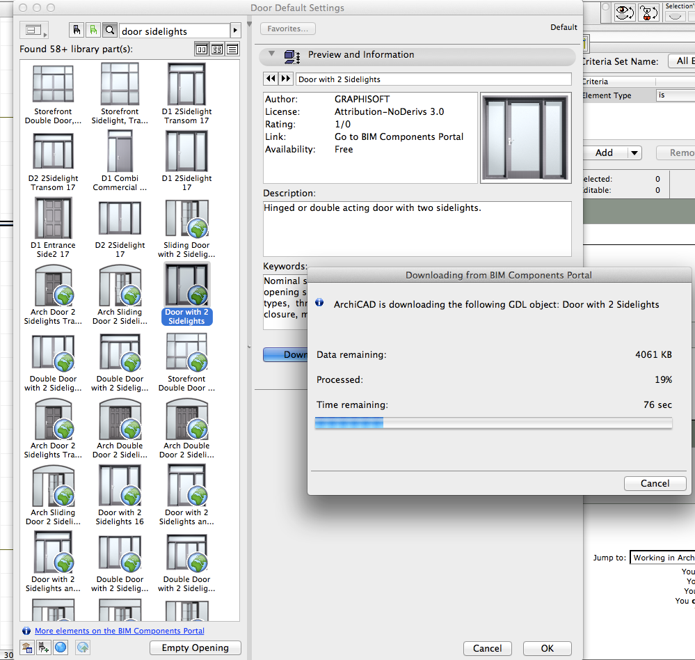

Rob,
from within 17 do a search of doors as shown in screen shot. This will give you the AC17 compatible version.

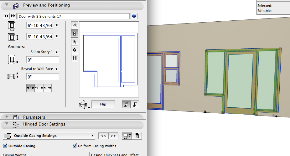

Kristian wrote:
Rob the door you are after is called Door with 2 Sidelights 17 (funnily enough)
The Shape options in the user interface is where you will find how to raise the sidelight sills.
Then the Opening type and angle gives you a double hung option windows!
Don't sweat it, your thousands of dollars software has you covered!

Erika Epstein
Download "Door with 2 Sidelights 17". This one retains casing.

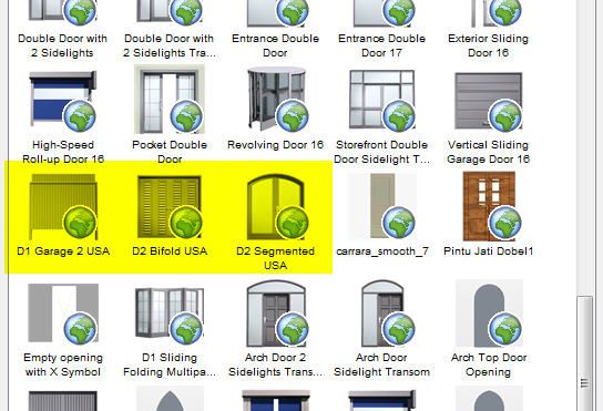

rob2218 wrote:
where did you find these "doors"? I mean...who makes them? why are they NOT part of AC if Graphisoft indeed is the maker of them?
why do we have to go hunting and pecking to find wonderful doors like these that do all sorts of amazing trim and sidelight gymnastics....as opposed to why aren't they part of Archicad's Library of doors functionality?
This door is part of the standard Archicad library as far as I can see - at least it is with the AUS version.
The USA version may be different it seems.
The BIM portal contains objects from anyone who wants to upload them so they don't have to be just from Graphisoft.
I believe also that Graphisoft upload all the various international versions so that everyone has access to them but I am not 100% sure on that.
When I browse for doors I see a few specifically for "USA".
